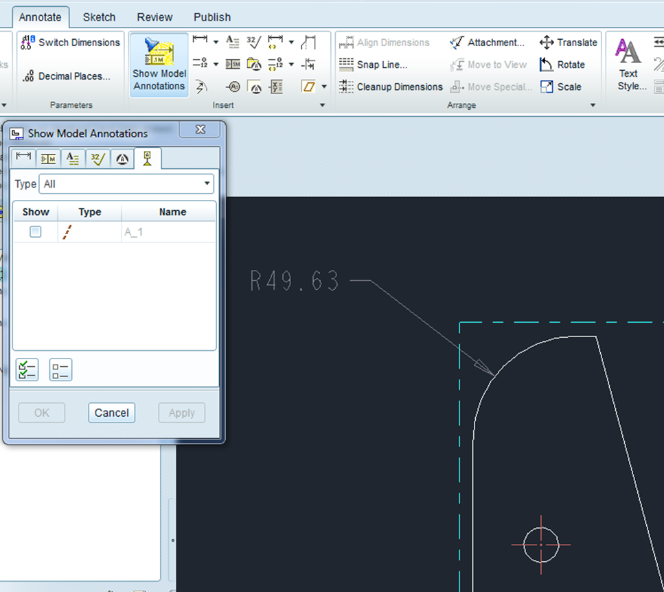

You can quickly make a centerline wherever you have axes in your model. Use Show Model Annotations to choose axes for centerline creation. Select the tab to the far right.

My question:
Does anyone know a workaround for resizing the centerlines shown in the image above. No matter which end you select and drag to extend the axis, all 4 ends will extend together. I want to be able to extend each one individually. I don't remember this being an issue before I used WF5.
