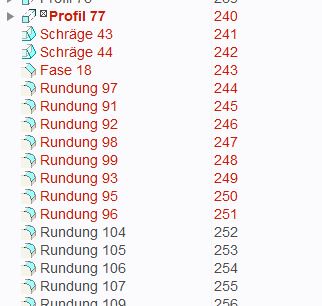

In Creo 2 Parametric, if an item is broken, then the dependent KE's are highlighted in red. I want to change the color of the failed elements from red to other color. See the picture for better understanding.
Under Settings > System Colors I have no appropriate setting found. In config.pro there is a setting: model_tree_font. But if the setting is to help and what should I write exactly, I do not know.
I need it for my college. He does not recognize the red light. Please help if it is possible.

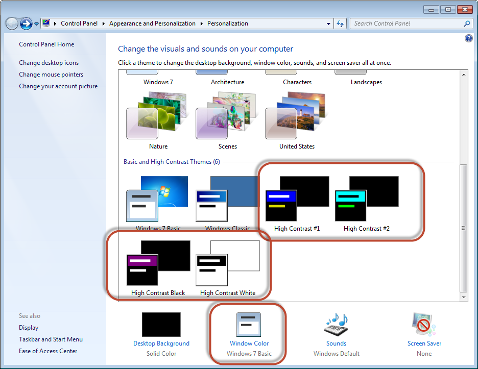

Viktor, while I cannot suggest something that will alter the failed component/features red font color, perhaps changing the background color behind that font will help your colleague see it more clearly.
That can be adjusted on Windows 7 computers by using the Control Panel > Appearance & Personalization > Personalization. Then select from one of the High Contrast Themes (or try other color combinations yourself using the 'Window Color' command).
Hopefully it helps a bit.
September 17, 2014
Ethan, thank you for your tipp. I will give it to my colleague.
