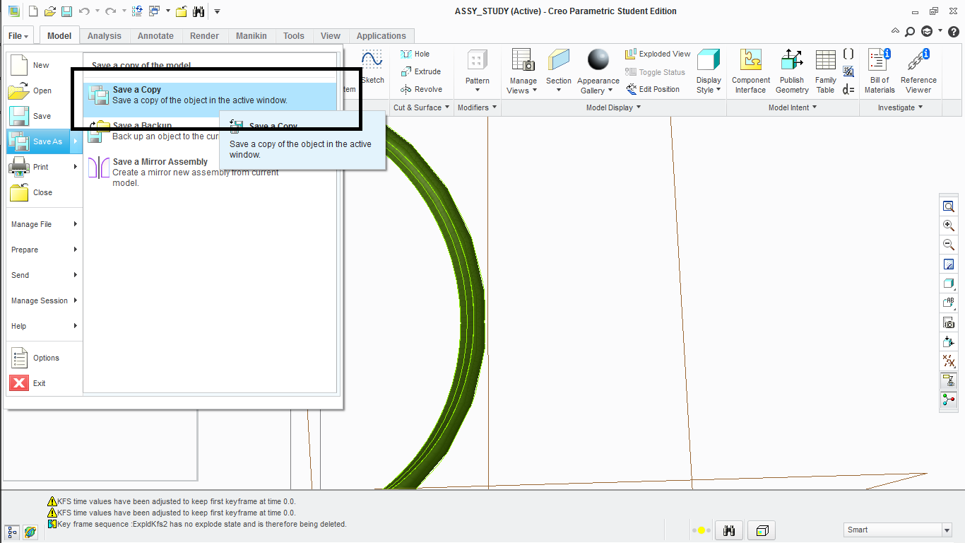

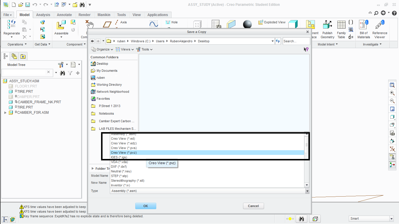

Using Creo (no matter the version) and saving a copy of the assembly as one of the four available files for Creo View, solve the problem.
