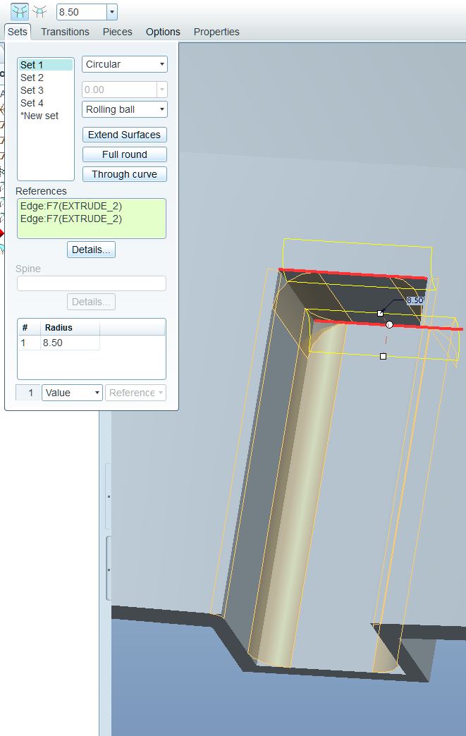

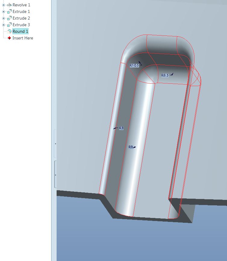

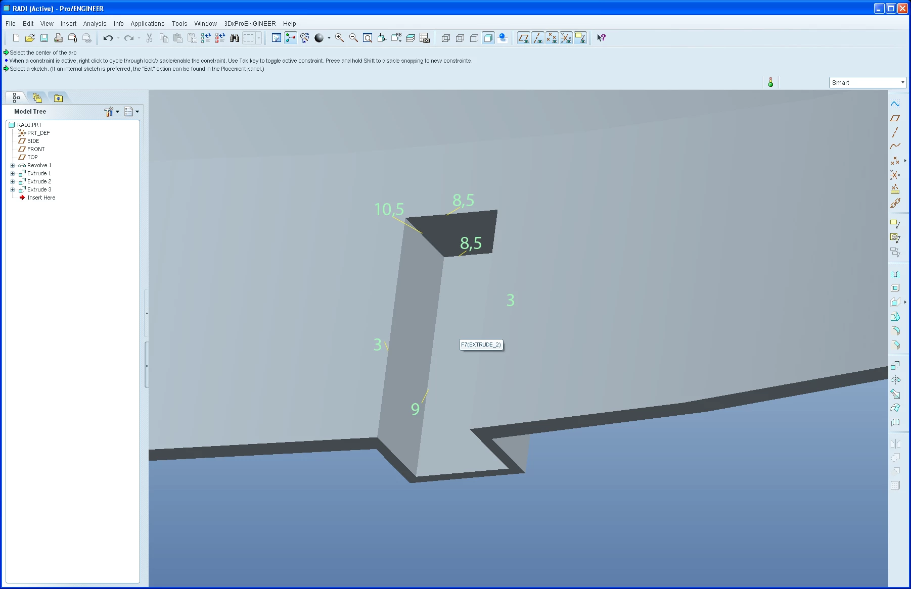

Is there a solution for my problem? I have attached a picture with the different radius and a ProE-part for you to look at.
I'm supposed to make all sharp edges round, but the radius are different for every edge.
If I for example make the radius 10,5mm and then select the one supposed to be 9mm ProE selects all way round.
Best answer by Nai
Just add all the different radius in a single round feature.
September 5, 2013
do the 3 and 9 radius first
next do the 8.5 radius..when you do the 8.5 below radius it will select the complete loop, press shift key and select the origial 8.5 edge
then in the end do the 10.5 radius.
September 5, 2013
Yes you can in round tool there is there is option for adding new set having different values.
Nai1-VisitorAnswer
September 5, 2013
