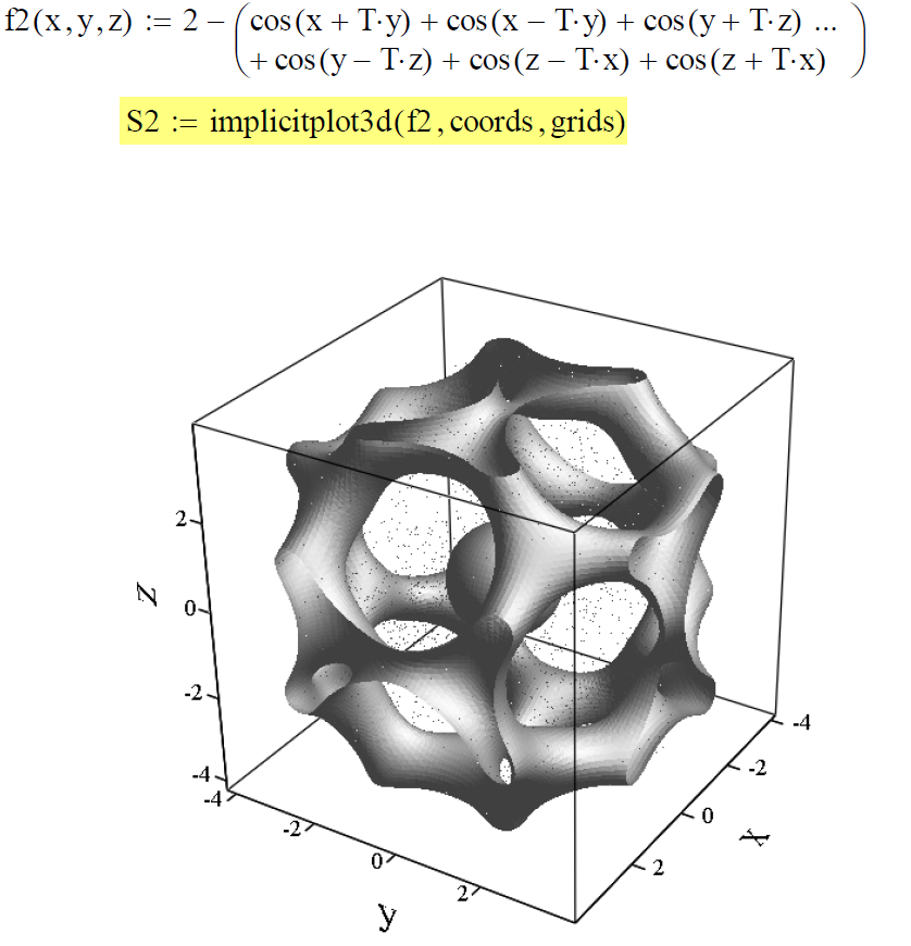

I do not recommend using this technique, as it is not documented and was removed after the MС11. I can show you how to use nested arrays with random data (numbers, arrays, strings). But it works only in MC11.x.
Here's what you can do once using nested arrays:
The archive is a project with dllimpliitplot3d() function, which takes a parameter as nested arrays and returns the result as a nested array. Comments in russian, sorry. If you want to understand how this works, you need to run the project under the debugger.
