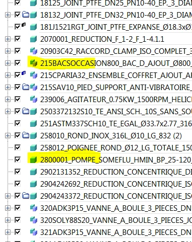

It will be very appreciate in new version after 20.2 to have possibilty to chose a color or a tag for each part in part list.

April 3, 2020
Ia was talking about the part list as we can have more than 200 parts in the same assembly, and names are not always the best to identify quickly some disired parts that we are working on.
For exemple orange for a part that will mean some work still to be done on it or green ok, etc ...
It could be also tags like stars, icons, etc ...
April 3, 2020
That can all be done with existing functionality.
It seems that you first need to specify clear requirements - then you can start implementing
this based on existing SolidDesigner I-KIT functionality.
Nobody except you can tell which parts should be marked as "green" (Ready).
If you are working with Model Manager, you are getting this for free.
Just *release* the parts that are finished, then they will be shown with a "lock symbol" in the parts tree
and you will not be able to make changes to such parts.
Also, using Model Manager, your parts have a Status that can be inquired via I-KIT (read-only yes/no),
so based on that it would be quite simple to assign Colors to the parts which are not "finished".
However, once you release such a part, you would need to update the color.
Overall, the idea initially looked simple, but may turn out to become a major effort.
