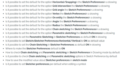

I found this, does one of these configs work?
https://www.ptc.com/en/support/article/CS69992?&as=1
