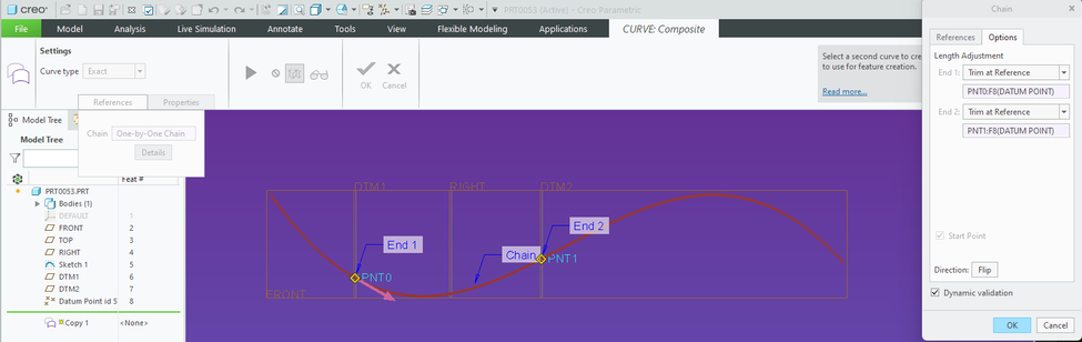

How to duplicate a local segment of a curve in a part and make the end point that generates a duplicate curve coincide with the two coordinate points
Involute Development, LLC
Consulting Engineers
Your request is a bit vague.  Is this what you are trying to do?
References / chain details / options: Change each end to trim at reference and select the desired reference (point, plane, line, edge, surface, etc).
