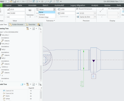

hello everyone

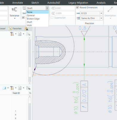

why I can't find the shaft and hole in the first drawing.what should I do to make the shaft or hole option apperance,like the second picture
thanks in advance.
ok, thanks a lot. and here is my actual action. also for others who suffer from this question to refer.
right now I know there is two way to retrieve the tolerance table. one is in the drawing mode, the other is in the 3D mode
At first, I only retrieved the tolerance table in the 3D mode. that is why I can't find the "shaft" or"hole" when I want to mark a dimension on the draft, but it works with the dimension on the Molel.
when I retrieved the torlance table in drawing mode, it works.
thanks again😊

Most likely you need to load the hole/shaft tolerance in your models. Follow the thread below and see if the steps outlined resolve the issue.
ISO Standard Fits and Tolerances - PTC Community
