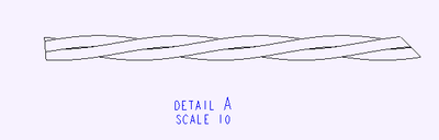

I am using Creo6 - version: 6.0.6.0

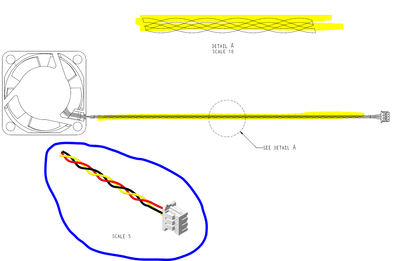

swept wire bundle using trajpar does not show hidden lines correctly in drawing view.
I've tried changing display settings, part accuracy settings; nothing seems to fix the issue; any ideas ?

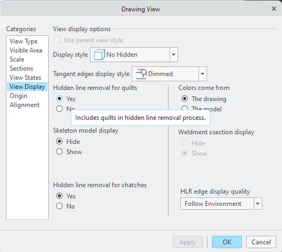

kdirth
(To:rburk)
Ensure hidden line removal for quilts is set to yes,

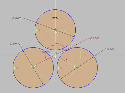

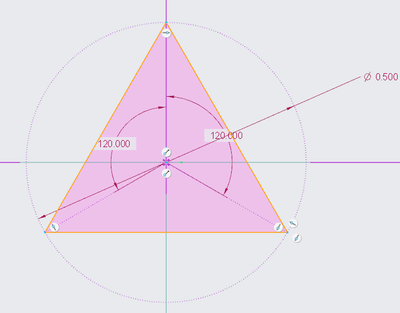

I have also had issues with this when there are surfaces intersecting one another.  In your case, (assuming the sketch below is correct) each wire has a shared edge (red circles) with both of its neighbors and  Creo can't interpret where the shared edge belongs and likely doesn't even know the proper orientation of the surface.  If you add a gap between the wires, I'm fairly confident this HLR issue will go away.
rburk
(To:aputman)
I confirmed sweep sketch has "gaps"
tbraxton
(To:rburk)
If the wires are tangent, that could be the problem. If they are tangent in the sweep section, then put a small gap in and see if that affects what is seen in the drawing.

rburk
(To:tbraxton)

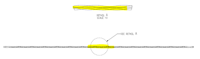

here's just the wire bundle only (no tangency) & settings  - still not showing correctly in drawing

aputman
(To:rburk)
If you turn on "fasthlr_drawing", the wire bundle displays correctly.  I don't know the full implication of turning on that parameter.

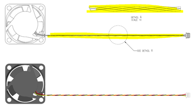

MartinHanak
(To:rburk)
@rburk wrote:
Hey Martin
I uploaded the wire bundle and drawing issue.
your model produces correct view until 6 rotations.
I added parameter MH and relation driving length of bundle.
Maybe the problem is related to model accuracy ... unfortunately I was not able to change it to lower value.

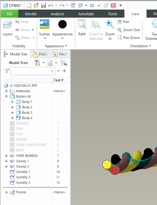

Something you could try is sweeping each wire individually rather than as a bundle.  Maybe the HLR process produces better results when the surfaces are separate features.
I tried it ... no success.
Maybe it is necessary to create bundle as assembly with 3 parts representing individual wires.
Martin Hanák
tbraxton
(To:MartinHanak)
I just tried using 3 bodies within the part in Creo 7 (1 for each wire) and that does not result in the drawing rendering accurately either.

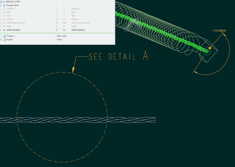

To me, it seems to be related using the variable section sweep (and the behind-the scenes algorithms that determine how often the cross-section is computed along the trajectory).  Just a gut feeling, but for example, if this is modeled using plain sweep + warp twist, the drawing shows up correctly:

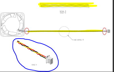

Here is what I get opening your drawing:
Not sure what the difference is in my config.  I don't have fasthlr_drawing set.
aputman
(To:kdirth)
Newer version of Creo perhaps.  I'm using Creo 8 and I see what the OP sees when I open their drawing.
