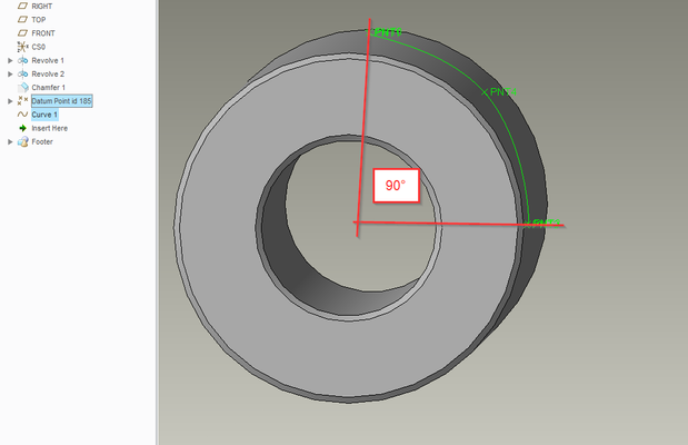

I'm trying to design a cylindrical part with 2 normal ribs on it. But first I like to have a curve on the outside of this cylindrical part.
What I've done is: I've created 5 points on the cylindrical part. These points are used to lead the curve through and then I've created a curve.
The problem is that this curve isn't staying on the outside surface of the cylinder...
Does anybody know how to solve this?

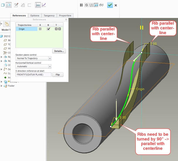

Next I want to create 2 ribs on the part. These ribs need to stay parallel with the centerline of the part.
I like to do this with a sweep, but the problem is that I'm struggeling with the settings of this sweep.
Anyone who knows how to solve this?
Hello @gpeetersem
Seems that only thing you missed was to constrain your Datum Curve through points to be created On Surface.
=> Attached a little movie of how I would suggest you to approach this.

Hello @gpeetersem

Hey Serge,
thanks for this video, this solved my both problems!

Hi @sacquarone and @gpeetersem
Note that such a groove can create a cleavage problem, sweep is a two-dimensional movement while the tool to create such a groove have a three-dimensional movement.
I create a perpendicular surface to the curve and then perform a thicken of material removal.
