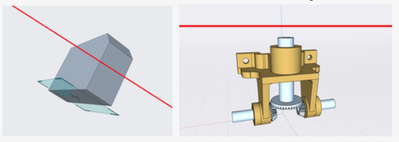

Auto horizon locking: Keeping the horizon always horizontal when rotating the view, which is equivalent to keeping the direction of gravity always vertical
Imagine you're making a model in the real world, you want to walk around your model to check its form or structure from different angles. But just as you start walking around the model, something magic happened, the horizon of the whole world began to tilt randomly. You have to struggle to keep your balance while continuing to think and create your model.-----This is exactly what happens when there is no "Auto-horizon-locking" feature.
This should be a function as basic as breathing in the real world, arguably more basic than anything else.
All existing relevant functions (orient mode ) are far from  "Auto-horizon-locking".They all require extra tedious and unintuitive steps.

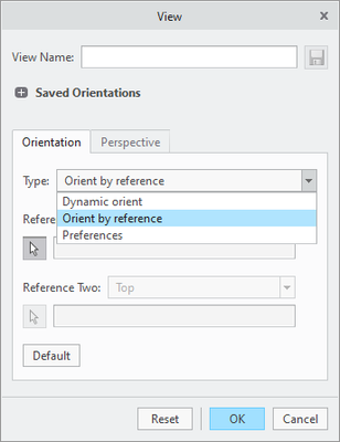

Creo Parametric does not have a horizon lock. You can submit a product "idea" here https://community.ptc.com/t5/Creo-Parametric-Ideas/idb-p/creoparametric
The only option that I have seen could be the re-orient window, where you can rotate based on horizontal/vertical/normal or any selected entity.
Go to the view tab, select the drop down arrow next to saved orientations, then select Reorient.
You can orient by reference (which is a select entity) or dynamic (which is horizontal, vertical, or normal to the screen)

Thank you for your guidance. There is no doubt that I do not represent all. What you said by using “orient by reference”  and choosing a Horizontal plane to rotate the view is close to what I mean by “horizon lock”. I just think that even if it's a "direction-independent" dumbbell, I still want the horizon of the environment that created it to be stable rather than spinning around. I appreciate your reply anyway. I will submit this product "idea"

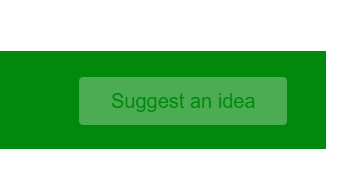

Walker
(To:StephenW)
 the suggest button grayed out
StephenW
(To:Walker)
I think that means you have to upgrade your level of access on PTC. You can go to https://www.ptc.com/en/support/ and then click on your name/avatar in the upper RH corner. Then either Manage my account or upgrade my account. I don't know remember exactly what is needed.
