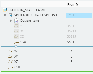

It is possible to find a reference in the component of a main assembly?
Using SEARCH_MDL_REF I'll try to find a CSYS in the skeleton part of a assembly.
I know about SEARCH_MDL_REF ASSEMBLY....
But how to search in sub-components of this assembly?

  • Skeleton must be in your active assembly
  • Skeleton needs a component parameter called BUW_OBJECT_ROLE value is of your choosing, but for this example I went with "skeleton"
  • Use SEARCH_SUBCOMP_REF to find the required reference.
See structure:
See also example code:
BEGIN_ASM_DESCR
	SEARCH_MDL_REF THIS_283 CSYS CS0 CSYS_FOUND
	SEARCH_SUBCOMP_REF ASSEMBLY SKELETON CSYS CS0 CSYS_TO_ALIGN
	CONFIG_ELEM
	ASSEMBLE THIS
		CSYS CSYS_TO_ALIGN CSYS_FOUND
	END_ASSEMBLE
END_ASM_DESCR
PFA also a litte demo component that you can use (Created in Creo 7).
I hope this is what you were looking for.

Hello Samuel,
I can found component in the equipment assy, but no success to find skeleton part in main assy.
please clarify, THIS_# statement can search in the assembly into which the user places equipment part/assy ?

This is was I'm looking for! Thank you, Samuel!
