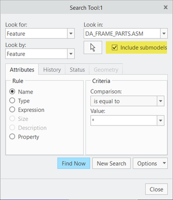

Have you attempted to include sub models in the search criteria?
• Look in (Available in Assembly and Drawing mode only) Select the active model. If the scope of your selection is already defined, this field is not displayed. The arrow button allows you to select the desired model from the graphics window or the Model Tree. Click the Include submodels check box to search the sub-models of the Look In model.
