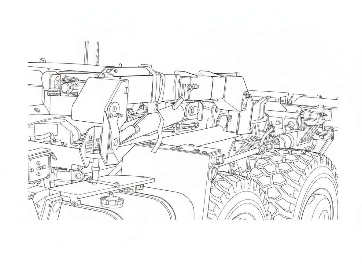

I did some deep dive into your prompt. Now it can create some serious line engineering data directly from PIC. One sample attached.
What would be the best way to bring it in my creo drawing? Any ideas. There are two ways I think of .
1. Bring directly as image
2. Convert to dxf and import in to drw
Any other better options? Thx in adv..

Actually,... no need to send me the output. The sample file challenge is for trials only to see how best close can get the image to line format as drawn on a drawing board. I can then convert to quality .dxf and merge in my .drg

Hi, Thats a good step to go for me. Can you help me find a good tutorial for how to do that? in Inkscape. A line vector from image pixel. See attached. What would be the best option?

Use image in drawing to place it.
