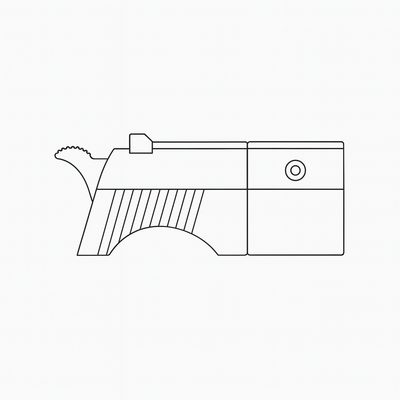

Hi ALL,
We are hearing and seeing a lot in action from many AI applications. CHAT GPT, Gemini,......
I am looking for a AI app that can do a 2D for me from the image.
NEED Suggestions on what out there available for this need.
See attach as as sample to try on . Pl use to try and send me the output . Appreciate!
THANKS IN Advance guys !

Have not looked at your image yet...I like Inkscape for this type of task.  Adobe has tools but I'm not real happy with all things Adobe.
...Now, I've looked at your image.  What you might want to do is turn it into a black & white image.  Then use Inkscape.

Actually,... no need to send me the output. The sample file challenge is for trials only to see how best close can get the image to line format as drawn on a drawing board. I can then convert to quality .dxf and merge in my .drg
Yogesh.T
(To:3dzign)
Hi, Thats a good step to go for me. Can you help me find a good tutorial for how to do that? in Inkscape. A line vector from image pixel. See attached. What would be the best option?

Prompt:
Black-and-white technical line drawing
Task
Convert the attached photo into a black-and-white technical line drawing suitable for a USPTO patent figure.
Framing & scale
• Present a wide shot of the entire object, centered on a pure-white background.
• The object must occupy no more than 60 % of the canvas in both width and height, leaving at least 20 % blank white margin on every side for future annotations.
• Keep the object’s flat front view orthographic and proportions exactly as in the photo—do not rotate, skew, or alter its geometry.
Style & execution
• Clean, minimal, vector-style line art only.
• Uniform stroke weight; high-contrast black lines on white; absolutely no shading, color, textures, or background elements.
Detail fidelity
• Reproduce every visible mechanical or structural feature: edges, contours, holes, fasteners, seams, surface transitions, etc.
• If any portion is obscured or out of frame, terminate the geometry cleanly—do not invent or infer unseen details.
Negative constraints
• No close-ups, cropping, zoom-ins, or artistic reinterpretation.
• No added features, embellishments, or background objects.
Output requirement
A single high-resolution image that reads like a traditional cad drawing view: crisp lines, consistent stroke thickness, generous white space, ready for annotation.
