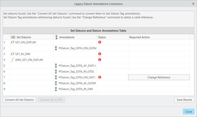

2. Also in case that you revise the GD&T in a legacy drawing/model to work per the new datum rules, you might want to consider using the Legacy Datum Annotation Conversion tool:
 This tool will be a good guideline for users who wish to migrate their old set datums to the new DFS datums, while keeping properly the relation between the new datums and the gtols that were previously referencing them (and keeping them associated)
I hope that this will help
