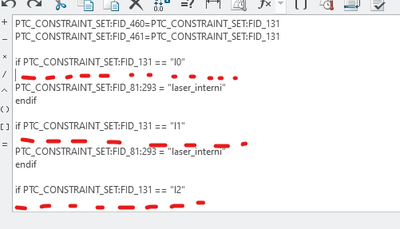

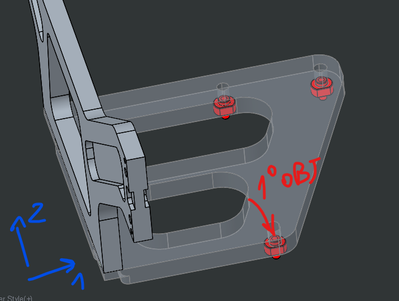

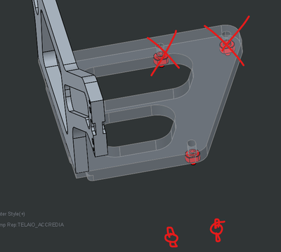

I've done a direction pattern with respect to the blue directions (of another object of the assembly) in the picture.
With relations, I want to invert the direction of the pattern in relation to the constraint of the first object of the pattern.
Wich is the command that I have to insert afther the if conditions in the following relations?
Thanks a lot.
Michele Barile
you could use a relation like this:
/* PARAMETERS FOR DIMENSIONS PATTERN
1_DIRECTION = 50
2_DIRECTION = 150
/* PARAMETER SET
PARAMETER_SET = 1
/* IF CONDITION
IF PARAMETER_SET  == 1
$d4 = 1_DIRECTION
$d5 = 2_DIRECTION
ENDIF
IF PARAMETER_SET == 2
$d4 = - 1_DIRECTION
$d5 = - 2_DIRECTION
ENDIF
