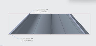

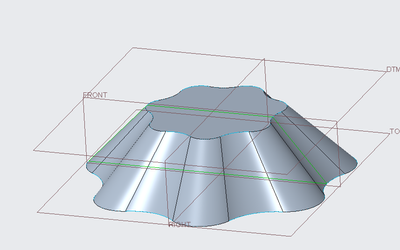

The base shape is this which I created by blending two sketches.

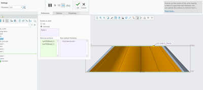

I would like to remove the top and bottom surfaces and have differing thickness walls at the top and bottom of this object; as in the wall thickness is greater at the bottom and it decreases gradually towards the top.

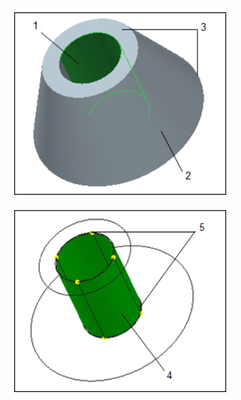

The closest example to this that I've seen is example 2 here :
https://support.ptc.com/help/creo/creo_pma/r9.0/italian/index.html#page/simulate/simulate/exam_variablethickness.html
I am unsure on how to achieve and help would be appreciated.

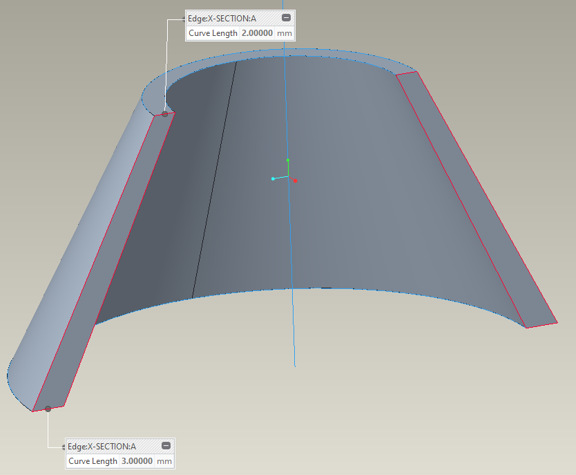

To model this using the method you have with the existing geometry you can make another swept blend between another 2 sections that represent the wall thickness at the sketch planes. This second blend will create the cut resulting in the variable wall thickness. Here is an example of how to do this using a cone for expediency. You should be able to use the same approach with your geometry.

Thank you very much, this worked perfectly. I also learned I can save analyses due to your video so another thanks for that.
