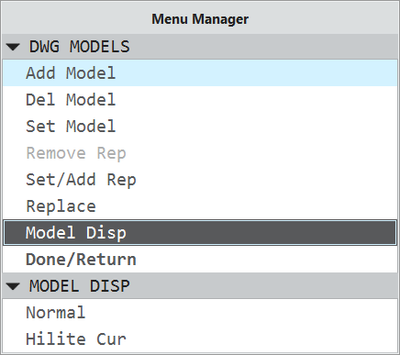

Hmm, not sure how you are thinking of using this "drawing bill of material".  Seems like a pretty basic thing to have so I was surprised to see that there is no such function as "drawing information" in Creo 4. But then again, I suppose I never had to use something like that before...
I think of other ways to get at this information:
1) The list of models and the active model is readily available in the status bar:
Active model highlighted.  Double clicking there will show a list of models in the drawing.

There is also this "Hilite cur" option available which will draw a box around views that belong to the active model:

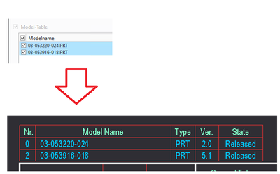

Right now we have an application that enables us to generate a table on the drawing where all or some models can be listed with an unique ID. With the new version we do not have this functionality anymore and I now trying to find an alternative method to have at least all models that are connected to the drawing - and that should be automatically.
