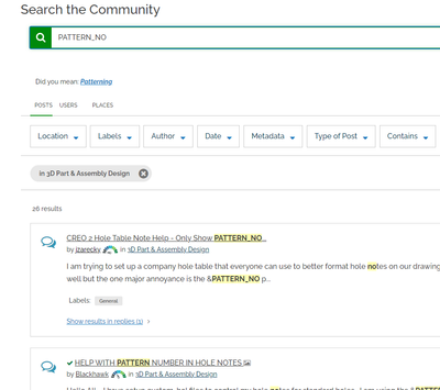

PS. I'm curious about your question as simply searching for PATTERN_NO on this forum revealed several discussions about it, and the 2nd one has my (repeated) answer.
So... did you try to find the answer and it wasn't visible because you were in the wrong "community?"
From personal experience, the forum is hard to navigate, so just asking...
