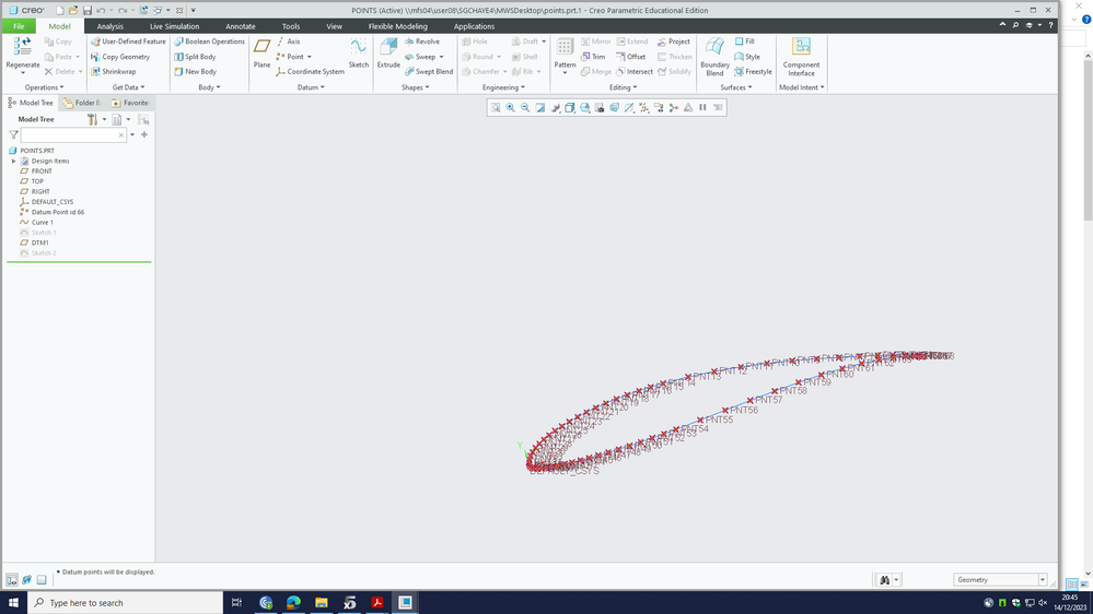

I want to create an aerofoil with ribs and spars like below. The curve that I have made doesn't allow me to extrude it, therefore I have to use the 'spline' tool to sketch over the points. However sketching over the points makes the aerofoil inaccurate. Is there any other way of doing it. I can't use the blend tool because I want to show the aerofoil in its individual parts like below. Thanks very much.

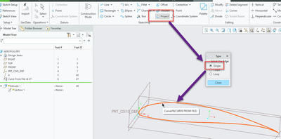

Have you used the Project command, as already suggested, to copy the curve into your sketch?
