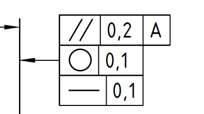

Hi everyone,
is there a setting so that the symbol field (first field) becomes the same size?
stacked_gtol_align is set to yes, but that only aligns the last bar
Thanks for your help
(I use Creo 9)
Hello all,
the solution was actually quite simple. My mistake was that I had set ASME as "language"/default in the din.dtl and not ISO.
After I changed that, the symbol sizes matched.

I think if you read Appendix C of ASME y14.5-2018, you will see that the symbols are different sizes (all a factor of the set lettering height) and therefore the box around the symbols will vary in width. I do see in your example that the value box varies in width to get the right side to align, so there may be some flexibility in building the boxes so all vertical lines align. If they do adjust the box widths, I would like to see all symbols and tolerance text centered in the boxes.
Hello all,
