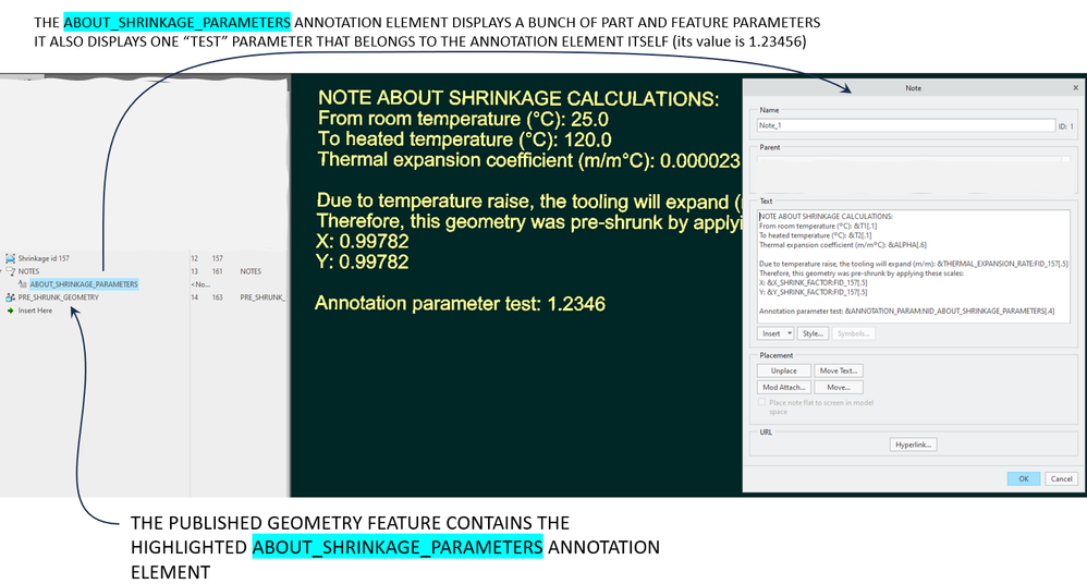

Hi, using Creo4 here and I am wondering if I am doing something strange but this was not quite expected:
I prepared an explanatory note that is attached to geometry that is being brought in via the extern-copy-geom mechanism.

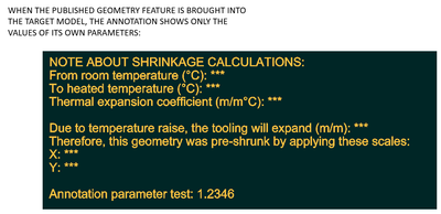

But the parameters displayed by this note, which show up just fine when viewing the source model, disappear when the note is rendered in the target model:
How the annotation and published geometry was prepared in the source modelHow the annotation and published geometry was prepared in the source model
What the published geometry looks like in the target modelWhat the published geometry looks like in the target model
I realize that to get around this *** issue, I can craft my note to only use its own "annotation element" parameters.  And via relations, those can be made to be equal to the "original" feature and model parameters.  But that seems like twice the work...
