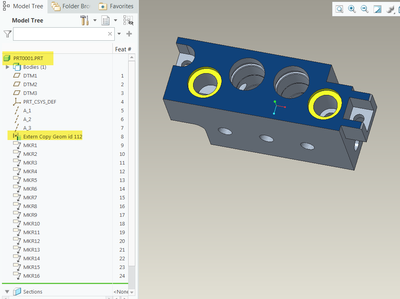

Is it possible to propagate an appearance, defined in a multibody part, down to a dependent part defined by one of the bodies?  For example lets say you have a surface and you want to shade it with two different colors in order to communicate two different textures to a mold maker.  If this is done in the multibody part can it be propagated down to the dependent parts?
tbraxton
(To:Carguy131313)

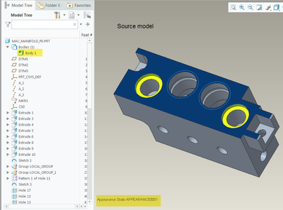

I believe that you are referring to an appearance state. If you create an appearance state in your model and then use the create part from body option to make a derivative part then the newly created part should have the appearance state that was active on the body when you created the part.
Here is an example:
The blue and yellow surfaces are part of an appearance state created in the source part.
The derivative model created using Body 1 above created with the appearance state 1 active:
The blue and yellow surfaces are carried over as seen below.
I believe this appearance is persistent in the derivative model and is not parametric with the source part. If you are asking how to make the appearance of a part derived from a body then you will have to ask PTC support.  Appearance states are not copied over to a part derived from body as described above.

Hello tbraxton,
Thanks for the reply.  Can you elaborate a little on second statement above, "Body characteristics, such as body name and body appearances, are transferred".  The transferring of the body name is pretty straight forward but I do not see how to consistently transfer the body appearance.  I was kind of hoping that if a created a named appearance in the view manager that this same appearance would be available in the child part.
Thanks in advance.
tbraxton
(To:Carguy131313)
Here is an example:
Involute Development, LLC
Consulting Engineers
Okay, thank you for the clarification.  I was hoping there was a way to maintain the appearance state in the multibody part and have it parametric to the derived part but at least now I have the answer.
