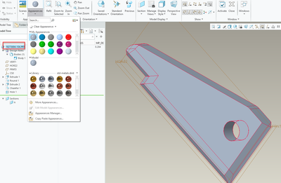

I have applied an appearance to a model for carbon steel. I added the appearance by highlighting the whole part, then selecting the desired appearance. Where the issue comes into play is if you modify the part in any way, it will change the cut/intersected surfaces back to the default generic/grey appearance while it needs to be the new carbon steel appearance. Is there some sort of setting to fix this? Please see example below.

The way I get the part appearance set so cuts don't affect it is I pre-select the part in the model tree and then select the appearance I want it to be set to.

@StephenW Thank you, this is exactly what I was looking for! It appears that before when I was clicking and dragging to highlight the model it was only grabbing the exterior surfaces and not the body itself.

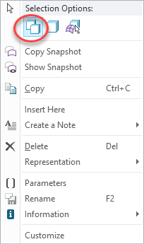

BenLoosli
(To:JS_12786992)
What version of Creo are you using?
Did you select the individual surfaces or the part option by using the drop down menu in the lower right of the screen?
You need to use the body option to get the full solid to take on your new appearance.
