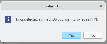

The problem I’m encountering with the rule (&asm.mbr.name != part_a, part_b, part_c) is that it imposes a restriction on the number of assemblies (due to a character limit), beyond which it triggers an error.
