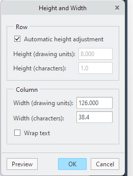

Hi all, first post!  My question is that the way we like our text within our tables to look is centered horizontally, meaning the box borer spacing above the text is the same as the spacing below the text.  When I select the 'Automatic height adjustment' box, the lower border is much closer to the text than the upper border.  Is there a way to change the "cell padding" around the text to center this?  I've searched for config parameters on this with no luck.

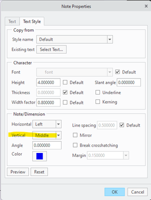

There are 2 things to look at: height and width and note properties - text style

So the first is me setting the height of the table row as I would like it... same amount of space top and bottom.  6.76 "drawing units" is what I used.
The second is turning on the "automatic height adjustment" which (at 7.938) has way more space below the text than above.  Looks sloppy to me.
I don't want to use middle for the body (change description) because then I would have to use it for all my columns or they would not line up.

Try adjusting the line spacing factor to match the top offset.  Not sure exactly how it works but it will adjust the bottom offset with automatic height adjustment.  It appears that automatic height adjustment puts the line spacing under the last line.
