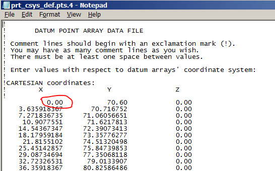

Thanks for your response. I imported the points using a .pts file and then I changed the coordinates of some points in that .pts file and tried to regenerate the model, which didn't happen. The relation between the points should be:

Once you read a ".pts" file to use the points, you're done with the file. There is no connection between the file and the Creo model. The file just provided the initial values for the points and is never referred to again. You could delete the file and it wouldn't affect your model at all. It's just input. You'd have to redefine the points within Creo, if that's possible.
edi
(To:KenFarley)
yes that is true. I realized that when I import the points and once they are in the model tree if I edit the coordinates they actually update. I just need to figure out how to create other points from them. I'm working on pattern without any luck so far.

1)  you seem to have been trying to edit the points by modifying the values in the .pts file used to create them.  As you discovered, that does not work because there is nothing linking the .pts file to the model.  However, it still might be easier to edit the .pts file externally (e.g. using notepad++ or excel), save it, then edit the definition of the point feature, delete the previously imported points from the table and then "import" the updated .pts data.

Actually I made a little mistake. I was re-importing the points which lead to regeneration failure. I used the update bottom and modified the coordinated in the notepad tha poped up and regeneration was successful.
Thanks  for all your efforts and suggestions. I can move on to the guide vanes now.
