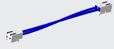

I do not have a wiring schematic for my harness I need to model in 3D, however I have a table of this wiring harness that I would like to use to automate the creation of a wiring harness.
In this table, I have wiring to, from, and what the wire gauge is as well. There is some other information however that doesn't seem necessary.
I see that it's possible to use a  .NWF file to autoroute, however I do not have this. Would it be possible to use this data to create a .NWF File in order to automatically set up the wires in creo? This would reduce my workflow immensely.

I think that PTC doesn't have any tools to create the .nwf files from e.g. excel tables.
Many people have done different tools to create the .nwf files from excel table etc.
Here are links to some past discussions of the topic...
Problem with these tools is always that you have to maintain them yourself. Creo Schematic is the tool that PTC offers for harness designs...
It shouldn't be too hard to create a macro yourself from your connection table.
Here is an example of a simple two connector, two wire .nwf file.
a) Schematic
b) How it looks in Creo
.NWF file

So it seems that you need the connectors, refdes values, entryport pin names, actual Creo model names (JST_VHR-2N.prt), cable info, and the connection info on your table...
Hope that any of this information helps...

It does seem like creating a script is the best method of doing this. Thank you for your search on this topic, PTC's documentation on this topic isn't very thorough.
