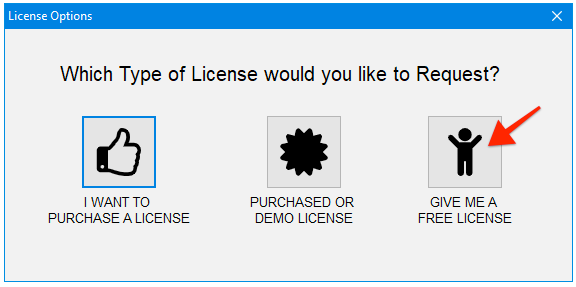

Any reason Nitro-BOM can't handle this renaming for you -- then just regenerate the drawing when done?!
NOTE: Drawing and Models must be in session together to pull this off.
You can just download the software and request a FREE license to give it a try.....

information for all testers ... FREE license enables to generate BOM for small assembly, only (up to 25 unique assembly items - top assembly included). I think it is better to request DEMO license to test Nitro-BOM with any assembly.
