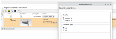

There MAY be a way to do it in windchill, check with your admin.  We have it setup to create a PDF and Creo View (hate the software) representation whenever a part is changed, even if it's not an "official" revision change, just an iteration change.

There must be some way in windchill since you can download the thumbnails as jpg. Try to search more about WVS jobs and publishing
