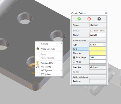

Between two points radially pattern option
Ertan_Akbayir
When we radially pattern a feature, we need centering circle, hole etc. NX has an option like between two points. It is very useful when there is no feature in the center of pattern axis.

You can create an axis between the two points (that I assume you already have) and do the pattern around it.
If you want to suggest a new feature, you can do that here: https://community.ptc.com/t5/Creo-Parametric-Ideas/idb-p/creoparametric
