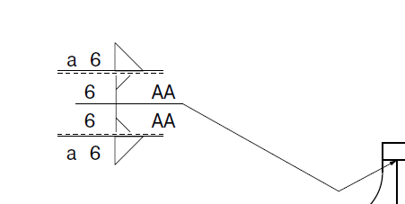

I'm looking for a way to make a weld symbol that looks like this:

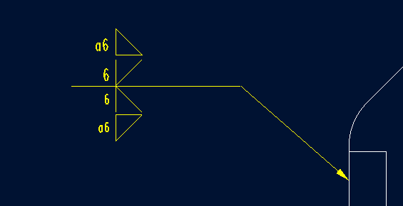

The closest that I found is a symbol, modified years ago by a colleague who is no more, that looks like this:
Problem is it's just not very accurate - reinforced half-V should be reinforced half-Y.
I've tried to use the symbol editor to modify a copy of this thing, but to no avail. I don't know what lines to change/add and how this will work in symbol properties. Ideas anyone?

Oops, added the wrong sym-file to the original message.
This is the one.
Found the edit button and replaced the file in the original message.
