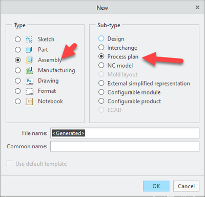

I haven't used it in years but there is another option. Process plan for assemblies.
It allows you to create process steps without affecting the original model(s).
A quick search I found this document http://www.datajett.com/Cadd/ProE/Tuts/HawkEye/Proprocess.pdf (from 2000)...

Unfortunately, the BOM table is tied to the representation that it is made from, and balloons cannot be made in views that do not use that representation.
For this situation I blank those parts that I don't want to see.  If your model tree is ordered as assembled, you should be able to shift select parts in the tree to quickly blank the parts you don't want to see in the view.

This sounds promising. Let me give it a try. But in the meantime, I have used layers: added components into different layers and used them in combined states and used them on the drawings. It seems to be working for my purpose now.
