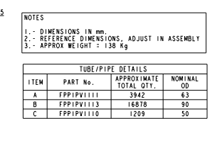

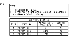

Hello all,
We are using Windchill 11.1 M020-CPS16 with Creo Peramatric 5.0.4.0. I have Published a Drawing and gererated the representations from the Windchill and Creo but the values are different in both of the representation.
Generated from Windchill -
Generated from Creo -

Are you publishing latest or as stored? My guess is that the CAD was changed and the drawing was left behind. Try iterating your drawing to fix the published content. If you publish as stored, you need to make sure to check out and regenerate your drawing when CAD changes are made.
