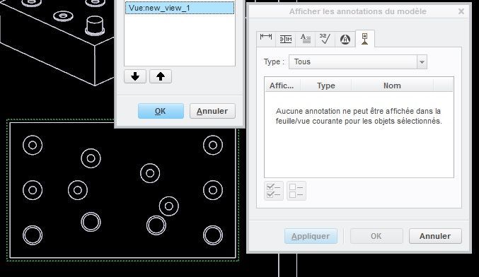

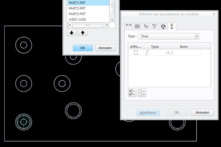

Why, whith the new version of CREO3.0, when you select a view (in a drwaing), it's not possible to show all the axis of this view ?
The only possibility we have found it's to select each component (part only, not assy).

Set config option show_axes_by_view_scope to all_sub_models, it will help you.
PTC changed the show functionality when selecting by view of asemblies. There are times if you show dimensions or axis by view it would take a long time (large assembly).
If i'm not mistaken, it now only shows the top level axis when selecting by view (of an assembly).
