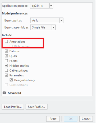

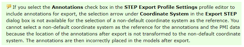

Got it.  You cannot choose a coordinate system when 'annotations' are included.  Uncheck those and then you can pick a csys.
