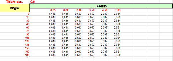

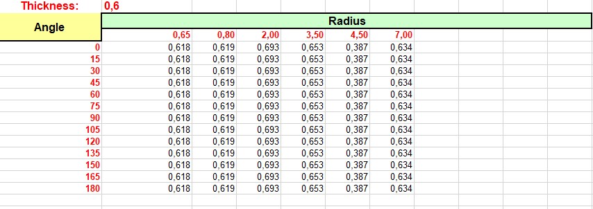

We received from customer Bend table in format which SolidWorks read well,
so we are trying to apply that in Creo (Creo 11.0.3), but as we noticed Creo has a little bit different format. It has radius and thickness and values inside are bend allowance if i understood correctly, and the table from SW have thickness, radius , bend angle (which is not affecting k-factor if u see table, so it can be ignored), and k factor as value derived (0.618, 0.619, 0.693....).
Does anyone know how that should be applied in Creo and have maybe some examples, or is bend table a right way in Creo to apply this.

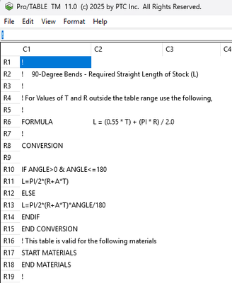

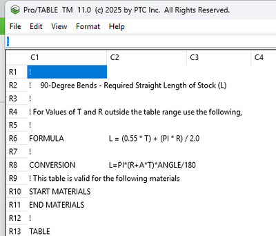

Thanks for your answers because i didn't get it from much people 😁. I was a bit busy and didn't have time to reply (on my own message), because it felt at some point like PTC community is a ghost town, than @Catalina  and DB@HuscoInt replied and reminded me that this topic is still alive. You were on the right track, but in your example interpolated values (A) are L (which i figured it out at some point), so for people who might read this post if they want to have k-factor read from table not directly Bend Allowance, you will need to have conversion formula. When you don't have conversion formula L=A (A=Interpolated values inside table) by default. So CREO system formula is L=PI*(R+k*T)*θ/180, and when you use conversion formula you swap k with A, so the k-factor will be read from table, and it looks like this L=PI*(R+A*T)*θ/180 (Pic1)If your conversion formula is a bit complicated you need to put end conversion at then end of you relation (Pic2). So i will Accept this as a Solution to close this Topic.

Attached is a sample I created based on your screenshots. Creo’s bend tables typically don't vary by angle only by thickness and radius. This is why I removed all the angle rows because the values are identical. I could not upload the file as a .ptb so you will have to rename from .txt to .ptb.
