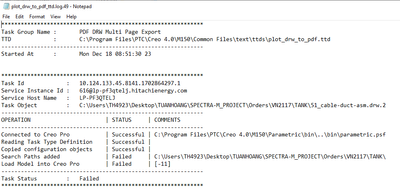

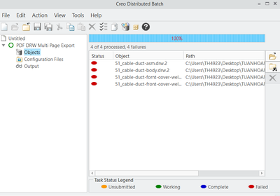

Hello everyone,

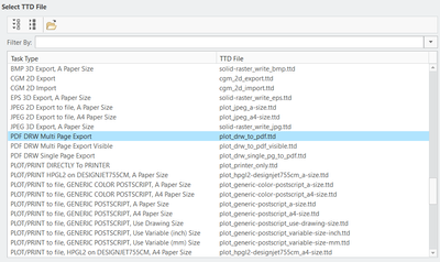

I have some problems with Distributed Batch, I'm using PDF DRW MULTI PAGE EXPORT to convert some drws to PDF.
But it fails then can't proceed,
Here is the log file
