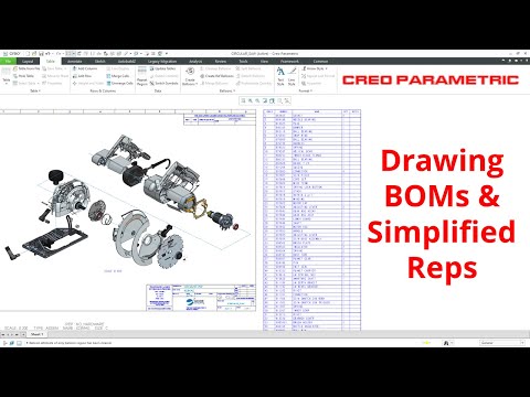

this may help you
This Creo Parametric tutorial shows how to use a Simplified Rep in a Bill of Materials (BOM) on a 2D drawing and then how to show balloons in the drawing view. For more information, visit https://www.creowindchill.com. If you learned something from this video, please give it a thumbs up. If you ...
gkarthikyn
(To:rustys)
Video is not helping. Since issue is how to show same Balloon number in different REP.
