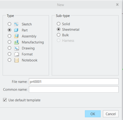

I made a part using Creo's Sheet metal with image below.
When I create an STL file and send it to our 3D printer, it makes it under millimeter only. Typically, it always ask if i want to convert to inches. When i load it into the 3D printer, it comes out super tiny and small. the problem here isn't the 3D printer, but the part itself.

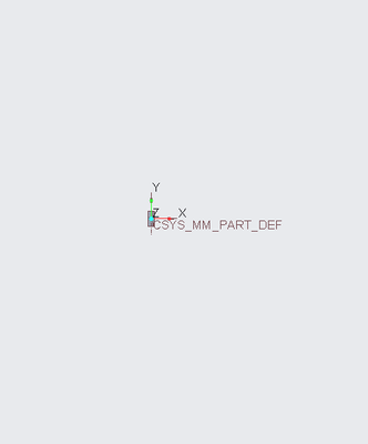

I have a big feeling it has something to do with this axis below causing this issue:
If i build it from a solid model, it doesn't have this issue. I need to build this part under sheet metal, because it will become a sheet metal.
Please help.

I've also come to realize. My Creo isn't converting the units.
When i create the part, Standard is in mm. I would convert it to inches and start building a basic square. When i dimension it as a "mm" rather inches (even though i already converted the part to inches), it would come out correct in the 3D printer. this is actually really odd. Has anyone ever experience this?
