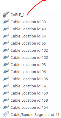

No matter what I use as the "cable_name", the result is 0. I have used "CABLE_1", which is at the top of the model tree, but the result is still 0.

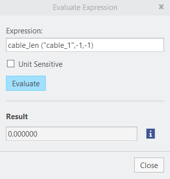

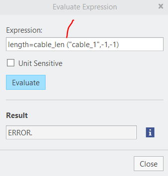

Here is the syntax I am using:
length=cable_len("cable_1",-1,-1)
where, "cable_1" is the first feature in the harness.prt as shown below. Note: the relation was successfully verified, but is stating 'Probable error in function evaluation.' Also, note that the relation was applied to the assembly containing both the harness.prt and the 2 connectors on either end of the cable. Thank you.

It appears your syntax is bad. You left out the "space" after cable_len in the relation.
cable_len ("cable_name",-1,-1)
Your relation omits this space.
"Here is the syntax I am using:
length=cable_len("cable_1",-1,-1) "

I added the space and evaluated. I'm still receiving an error.

I created a new cable assembly, entered the function, and evaluated. The result is zero. The cable assembly has 2 connectors with a straight length of cable spanning them (two cable locations). Measuring the length yields an actual result, so the same issue here.

I think the problem is your wire isn't named cable_1. Use the find command and change the look for to be cable. Then do history all. Find the wire you are looking for and then note the name after "cable:"
For instance the find results will look like:
Cable:w1:AssemblyName
In this instance w1 is the name of the wire/cable.
Its also possible that bundles can't be measured this way ... I just tried one (really short one) and got the same result as you. I don't have any other bundles to try quickly.

Chris, I have located the name of the cable using the find command. Per your interpretation, CABLE_1 is the name of the cable, so this does not appear to be the issue. I will try and run a wire instead of a cable next.

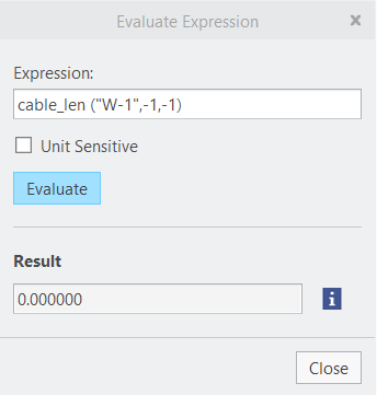

Same issue when running a simple wire. Result is zero.
