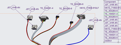

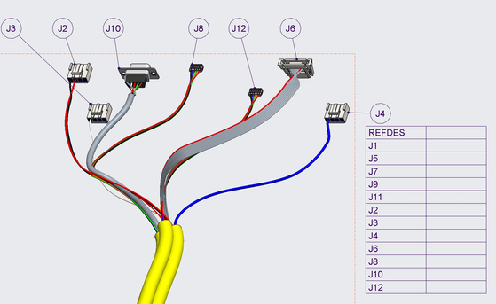

At least one way to show the connector refdes values for the connectors in the drawing is to (I'm using creo9)...

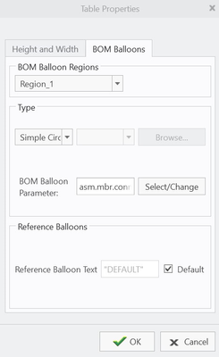

  • Create table for the assembly and open "properties" dialog for the table.
  • Set the "BOM Balloon parameter" to "asm.mbr.connprm.name"
  • Create balloons for the assembly and it shows the refdes values for each connector.

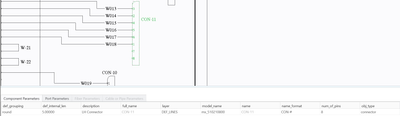

Unfortunately, my problem starts at Schamatics. There is a system parameter "full_name".
This parameter has the behavioral to be the reference designator. This means that if I place more than oncs the same component, the fill_name count this:
example_ Identify numbe and suffix 01...02...03 an so on.
That is way, I think, this is my reference designator.
But unfortunately, the parameter "full_name" will be not exported in the XML file.

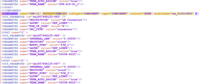

But isn't the "full_name" parameter from the schematic always exported as REFDES to the xml-file?
As here
Creo Schematic CON-11 highlighted... Full_name = CON-11
Exported xml shows the REFDES as CON-11

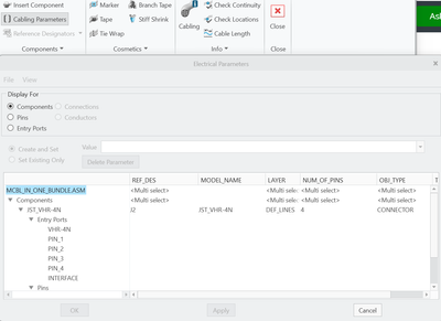

Then you can check from the cabling parameter in creo to verify that the parameter has been correctly read for the connector (here shown the "full_name" J2 from previous post)
Or do you just want to display the component name in each balloon (in my case the name does not fit inside the balloon)?
