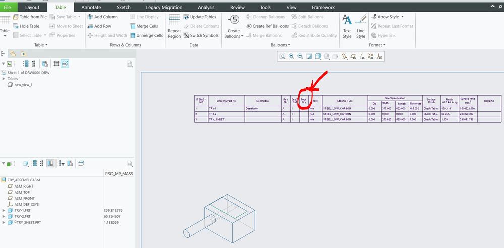

Dear Team,
I have created a custom parameter into the assembly, Now I want to call this parameter into BOM table. I know how to use repeat region, but I am not able to call the assembly custom parameter into drawing BOM table. Please help.

Hi Martin,
I have tried this, but not solve the purpose. I have provided some snapshot for your reference.
Please check the below snapshots.......
1. I have created Total_Qty parameter in my assembly....
  2. Now I want to call this parameter in my BOM Table....... What is the relation I have to use?

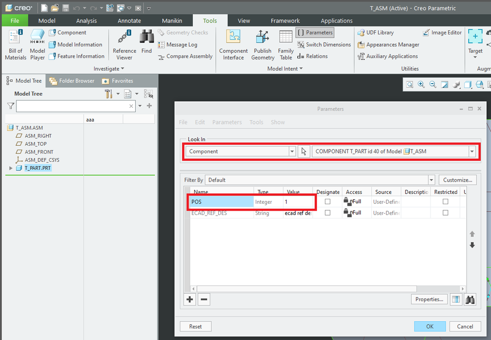

if I understand you well then Total_Qty parameter value is related to the component in context of the assembly.
If your Creo version is 7.0 or higher then:
  • download my test data set repeat_region.zip (2024-02-19 06:24 PM)
  • unzip it
  • open t_asm.asm
  • open Parameters dialog box ... see following picture
  • you can define Total_Qty parameter just as the POS parameter is defined

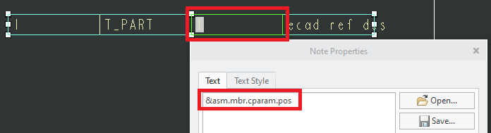

  • open t_asm.drw
  • edit contents of 3rd cell ... see following picture
  • you can enter &asm.mbr.cparam.Total_Qty to display value of Total_Qty parameter

Thank you so much Martin,
It works as expected.
Can you please tell me how to enter the parameter as a component, because it is not at a part level nor at assembly?
please see uploaded video.
