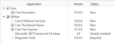

I suspect that you are not enabling the start option. If you are not able to reconfigure your existing install to enable this license you may have to uninstall. In some instances you may have to uninstall and reinstall Creo to get this to work.
Are you certain that when you are customizing Creo using the ptcsetup utility that you are not seeing any start up options or floating licenses available for selection?
Involute Development, LLC
Consulting Engineers
i hadn't thought of doing an uninstall.  coming up from creo4, I've only
done the reconfigure installs
One on top of the other.
I was going to do a creo 9 install in the morning.

I've continued to struggle with this and found that I do have Freestyle in my installation but....
If I import an obj using the import function under Freestyle, Shape, it does import the file including the "issues"
but what I want is to convert this to a file which can be edited as a part - faceted solid.
I select "reconstruct from facets" on the Freestyle menu over at the left and I see this on the bottom of the screen:
You have not checked out the license option. Please click "File->Options->Licensing" and choose required option from "Refresh license list".
Is it possible that the "reconstruct" function requires some other extension which is not identified and which I probably do not have?
Maybe this whole pursuit is nuts and I should just give up and construct the part I want in PTC.
