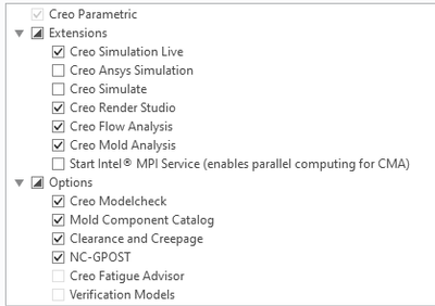

That is a startup option, not a config option. You need to obtain the license when starting Creo.
Directions to enable here:
https://www.ptc.com/en/support/article/CS29013

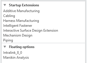

I did that.  the available license include ProE_EssentialsM  and Expert_MaCHINE_SET. There is no mention of Freestyle.  Although my installation is supposed to be fixed node, it seems to be running with some sort of license server because I'm asked to reconnect to the license server from time to time. If there is a license server, I don't know where it might be if it isn't on my system.  This is a standalone PC.
I don't know what your experience is with PTC, but mine goes back to 1988, and by far the most support time I've been involved with is licensing problems.
Licensing does seem to have gotten simpler in the last 5 years, but if this is a license issue, then more work is needed.

Open your Creo license file in a text editor and search for Freestyle_Design_Extension, if you see this in the license file then you have access to it.
Creo Freestyle Design was automatically added into any Creo Parametric license (in Creo 1.0). It is free of charge. It enables user to create freestyle features. While possible there are exceptions, it has always been provided at no additional licensing expense in the USA AFAIK.

I suspect that you are not enabling the start option. If you are not able to reconfigure your existing install to enable this license you may have to uninstall. In some instances you may have to uninstall and reinstall Creo to get this to work.
Are you certain that when you are customizing Creo using the ptcsetup utility that you are not seeing any start up options or floating licenses available for selection?

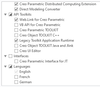

I could be wrong, but I don't think "Creo Freestyle Design" is something you can choose to install.  It's just 'there', sort of like 'Detail' 'Sheetmetal;, or 'Surface'.  There is nothing in the installer that I can see that lists Freestyle even though it's available in the license.

This may be the case on recent releases. When it was first available  (Creo 1) it required customization during install config. It would be in the startup extension box where you see ISDX listed. If it changed I do not know when that happened.

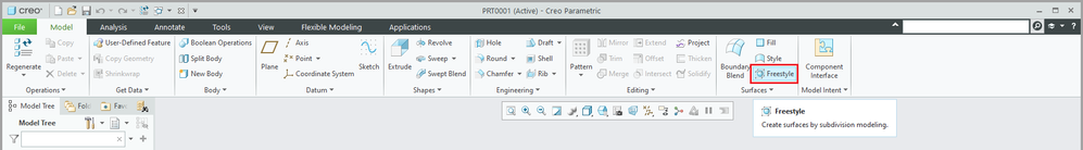

I've continued to struggle with this and found that I do have Freestyle in my installation but....
If I import an obj using the import function under Freestyle, Shape, it does import the file including the "issues"
but what I want is to convert this to a file which can be edited as a part - faceted solid.
I select "reconstruct from facets" on the Freestyle menu over at the left and I see this on the bottom of the screen:
You have not checked out the license option. Please click "File->Options->Licensing" and choose required option from "Refresh license list".
