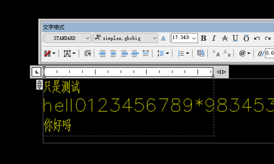

I means whether can creo map default font to two shx fonts for DWG file at the same time? one is english font and another is big font
such as map_font       isofont     txt.shx and gbcbig.shx
