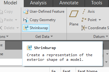

Yes. Shirinkwrap features are associative by default. If your SW features do not have dependencies, then they were intentionally created with no dependency.
Shrinkwrap Associativity
Shrinkwrap features are associative and automatically update to reflect changes in the parent copied surfaces. Shrinkwrap features are updated when components have been added or removed. You can control the dependency of the Shrinkwrap feature on the surfaces it references. The independent state is useful if you wish to avoid unwanted regeneration cycles.
When a sub-feature of a shrinkwrap fails, the shrinkwrap feature will also fail. Right-click the failed feature and redefine the references.
Copied Geometry Update—Set geometry dependency of the Shrinkwrap feature. The Shrinkwrap feature is dependent, by default, on the source components. If the size or position of the original component are changed, the Shrinkwrap feature updates accordingly.

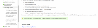

Yes, the reason is as follows:
Shrinkwrap Models (save as shrinkwrap)
A shrinkwrap model is an automatically created non-associative, simplified copy of a selected part or assembly.
The two main uses for a shrinkwrap model are the following:
  • Create a simplified model used to share geometry with vendors or customers while eliminating any proprietary detail you do not want to share.
  • Create a lightweight version of a complex part or assembly to be used as a reference or packaging model.
If you need associativity, then saving as shrinkwrap is not going to work.

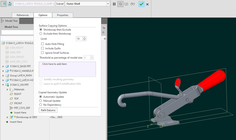

Perhaps I am misunderstanding, but I am thinking you should be making the "shrinkwrap part" by 1) assembling an empty part into your assembly, 2) activating it, and 3) using the shrink-wrap feature to generate the geometry?
The geometry in the "shrinkwrap part" can be modified using flexible-modeling tools:

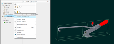

If the parent assembly changes (in a significant way):
then indeed the "shrinkwrap part" will need to be updated manually:
