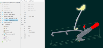

Perhaps I am misunderstanding, but I am thinking you should be making the "shrinkwrap part" by 1) assembling an empty part into your assembly, 2) activating it, and 3) using the shrink-wrap feature to generate the geometry?
The geometry in the "shrinkwrap part" can be modified using flexible-modeling tools:
If the parent assembly changes (in a significant way):
then indeed the "shrinkwrap part" will need to be updated manually:
